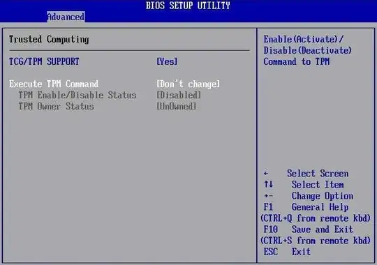

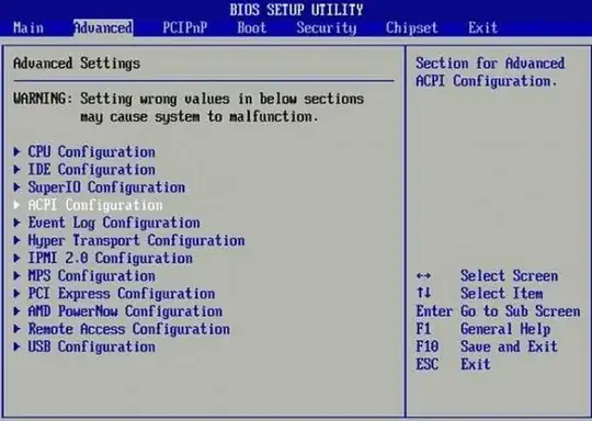

Regarding the Firmware bug: ACPI region does not cover the entire command boot message try switching off TPM and ACPI in the BIOS.
ACPI Configuration in BIOS
TPM in BIOS
TPM in BIOS
