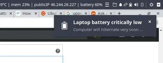

I have Ubuntu Budgie 20.04 and this worked for me:
cd /etc/UPower
sudo nano UPower.conf
If you set UsePercentageForPolicy=true then edit the percentage lines to your liking, such as:
PercentageLow=50
PercentageCritical=35
If you prefer a time based approach then set UsePercentageForPolicy to false and set the time notification options to your liking, such as:
TimeLow=1200
TimeCritical=300
Hit ctrl+X to save the UPower.conf file and close out of nano editor.
Reboot computer or sudo systemctl restart upower for changes to take effect.
By doing this I was able to get the low and critical battery notifications. The pop-up notification only displays for about 2 seconds. Here is what it looks like: enter image description here

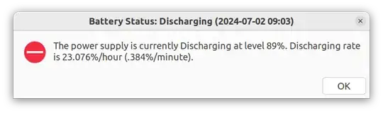

Sometimes while working on my laptop, when not connected to the AC power source, I get notified when power is critically low. I wrote this script which notifies me for every steps of 10% change in power level (for more details, please refer to the script code). For notification I preferred using zenity to notify-send as I frequently miss out to check such toast notifications while busy.
UPDATE: Now, also shows charging/discharging rates.
Script name: /home/username/bin/notification_battery_discharge.sh ;
