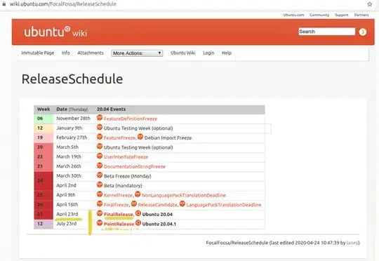

https://wiki.ubuntu.com/FocalFossa/ReleaseSchedule indicates that today (23rd April 2020) the new Ubuntu 20.04 LTS is to be released.
See "condensed screenshot" here:

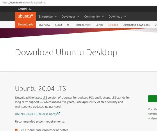

Indeed, it seems that that's what happened, see https://ubuntu.com/download/desktop and https://wiki.ubuntu.com/FocalFossa/ReleaseNotes:

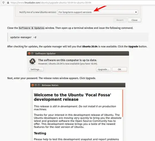

However, when following the instructions to upgrade (from 18.04 LTS to 20.04 LTS) found here and elsewhere (edit: actually in the official release notes, too!), even prior to the July point release, I'm a bit confused to see that the instruction is to use update-manager -d which also points to the "Development Release" (see screenshot below) rather than the "FinalRelease" (see screenshot and link above).
Is the "Final Release" (which I'm after) the/a "Development Release"? Why isn't it called something like "Production Release" or "Final Release"? When will it no longer be referred to as "Development Release"? In July? I'm confused :(
