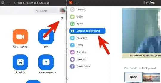

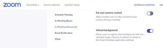

You have to go to: Settings > General > View Advanced Features > (the web site will open. log in) > Settings > In Meeting (advanced) > Enable Virtual Background.
For some reason, it is disabled by default in Ubuntu Zoom Client, and behave differently.
Then. in the Linux Client go to Settings and you will see a new submenu: Virtual Background
In previous versions (<5) a green background was required, it is no longer necessary and only a single colour background is needed, preferably green.
Hope this help.
