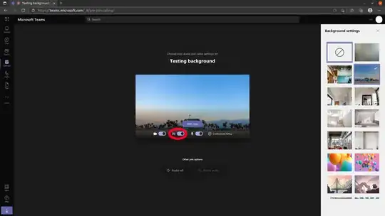

As of January 2022, the Teams Background Effects (change/blur) works in Microsoft Edge for Linux. I have it running on Ubuntu 20.04.
Here's what it looks like (option highlighted in red): enter image description here

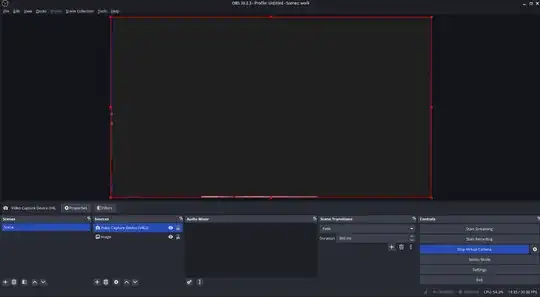

Use obs-studio with obs-backgroundremoval plugin.
  1. Install obs-studio
sudo add-apt-repository ppa:obsproject/obs-studio
sudo apt update
sudo apt install obs-studio
  1. Install obs-backgroundremoval plugin from Github releases
VERSION=1.1.13
wget "https://github.com/locaal-ai/obs-backgroundremoval/releases/download/$VERSION/obs-backgroundremoval-$VERSION-x86_64-linux-gnu.deb"
dpkg -i "obs-backgroundremoval-$VERSION-x86_64-linux-gnu.deb"
  1. Follow video instructions posted on Github to
    a. create a scene
    b. add new source: Video Capture Device (V4L2)
    c. in Video Capture Device (V4L2) Filters add Background Removal (see my params below)
    d. add new Source Image (your Teams background)
  2. Press Start Virtual Camera

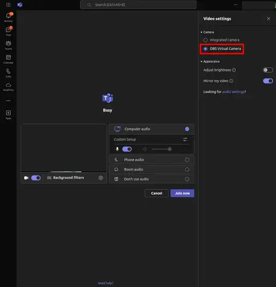

  3. Open Teams and choose OBS Virtual Camera
