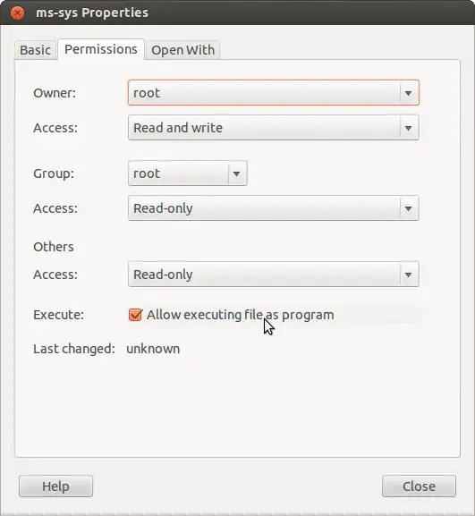

Check its executable bit.
If it's there but won't run, then as Chan-Ho Suh suggested in a comment, check that the file is marked executable.
You can see this in Nautilus by right-clicking the file and clicking Properties, then clicking the Permissions tab. You can see this in the terminal by running ls -l and seeing if the x bit appears. This wiki page explains how to interpret the permissions (see also this article).
If it's not executable, you can make it executable by running sudo chmod +x program (in the /usr/local/bin directory where it resides).
