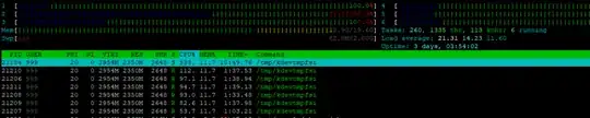

My Ubuntu server has been infected by a virus kdevtmpfsi, I have already done serveral steps to solve this problem, like all of these: https://github.com/docker-library/redis/issues/217.
But it is still coming again and again when docker container with redis is running.

Look at the image above, the "user" that is running this virus is a user "999" I have no idea how this is possible because this user does not exist.
What could I do to solve this?

Do a
chmod 000 /tmp/kdevtmpfsi
first. That will kill access to that file
From a user prompt if possible if that is not YOUR user:
sudo -u fabio
crontab -l
otherwise you only need the LAST line of these 2. If it is in there
crontab -e
to edit and remove that line. If not crontabs are stored in /var/spool/cron/crontabs/. There will be a fabio there. Nuke it all.
And it is not a virus. It is a miner that you probably installed yourself or installed as part of some piece of software. IF NOT consider your server compromised, format the disks and restore a backup. If you did please stick to regular and trusted sources.
edit: found some more about this.
Also related to this:
/tmp/zzz
That seems to be the bootstrap file. chmod that one too and nuke it after you verified you killed it or it killed itself.
The chmod removes permissions so the miner can not recreate the file nor write or read from it. Effectively killing it. THEN start hunting down the files. Nuke /tmp/* /var/tmp/* for anything with kinsing in the name plus the files listed above.
Try to execute deletes in ONE command so it does not get a chance to initialize itself.
