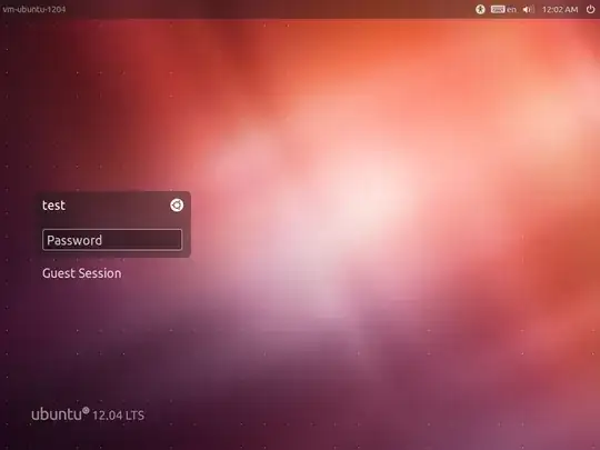

example of a lightdm greeter
From wikipedia:

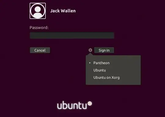

example of gdm3 greeter
From techrepublic

For the lightdm greeter, there is an round icon at the top right corner of the box named "test".
When you click on it, it will show the installed sessions and you can choose which one you would like to use: for example, ubuntu, unity (the one the OP wanted), gnome, etc...
For the gdm3 greeter, there is a cog wheel next to the text "sign in" that works to the same effect.
