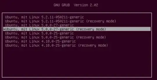

@chili555 answered this question. Here once more for everyone:
When booting into Ubuntu (where Ubuntu is the first boot option as specified in UEFI, i.e. the computer automatically boots into Ubuntu when you start it), press ESC once. You will get to the GRUB Menu. It will look like below if you are at the right spot (picture is from here). Don't press ESC several times, otherwise you may get to the GRUP Shell / command line, where you don't want to be.
Navigate to Advanced options for Ubuntu and select the older Kernel that is still there. Press enter and the computer will boot into this older Kernel. Then, you can check if the Wifi works again. In my case, it did.
