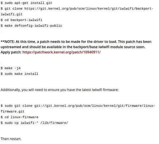

I installed Ubuntu 18.04 on a Dell XPS 15 7590 with a Killer Wireless 1650 2x2 AX Wifi card, but impossible to connect to wifi, with the following message : No WiFi Adapter found.
I found this answer which seems to work for some people, but not for me... The solution need an internet connection, and this is the current problem.
(The link doesn't work for now, so I put a screeshoot of instructions) enter image description here

I finally suceedeed, so I summarize the detailed instructions, hoping it can help some people.
  1. Apparently it's important to turn off your secure boot before the following actions.
  2. To fix the No Wifi Adapter found, you need a Internet connection. If you have an Ethernet port on your laptop it's good, else, you have to use an adapter. Personnaly I used a USB-C to LAN adapter and it works.
  3. Once you have a connection, you can update and upgrade packages (Maybe not necessary, but always good) sudo apt update && sudo apt upgrade.
  4. Execute all of the commands on this article:
sudo apt-get install git
sudo apt-get install build-essential
git clone https://git.kernel.org/pub/scm/linux/kernel/git/iwlwifi/backport-iwlwifi.git
cd backport-iwlwifi
make defconfig-iwlwifi-public
make -j4
sudo make install
sudo git clone git://git.kernel.org/pub/scm/linux/kernel/git/firmware/linux-firmware.git
cd linux-firmware
sudo cp iwlwifi-* /lib/firmware/
  1. Before reboot, execute this command to update initramfs update-initramfs -u.
  2. Now you can reboot.
You should be able to access wifi parameters now.
