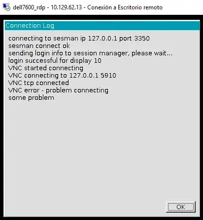

I mean to connect for the first time to an Ubuntu 18.04 LTS server via xrdp from Win 10. I can already connect with vino-sever and tigervnc client. I connect via VPN.
I followed this, but when connecting via xrdp I do not get the Authentication Required dialog mentioned in the link, step 3. Instead, I get
VNC problem
How can I fix this issue?
Do I have to kill vino-server, or can they both be active simultaneously?
Do I have to enable RDP port 3389? How? I guess this is ok, since when the xrdp window is open, I see

There is no enough information in your question to provide a 100 % working solution... Your issue is probably related to the fact that you are running an not up to date Ubuntu 18.04 version. We are guessing that you are running Ubuntu 18.04.2.
As described in this post, in Ubuntu 18.04.2, the xorgxrdp package does not get installed because of missing dependencies....
To fix your issue, you have multiple options
Option 1
use the easy to use xrdp-installer-v1.1.sh script that will detect and fix the possible missing dependencies. Please read the info provided in the post to learn how to use the script properly...
Option 2
Upgrade your Ubuntu 18.04.x with the latest updates (which will bring your Ubuntu to 18.04.4) and remove/install the xrdp package manually using the following command
sudo apt-get install xrdp
sudo apt-get install xorgxrdp-hwe-18.04
Note : To check which version of Ubuntu you are running, from a terminal console, you can issue the following command
lsb_release -a
