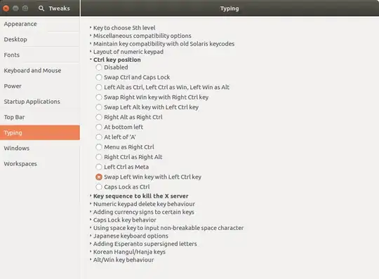

To swap the Control key and the Super(Command) key:
sudo apt install gnome-tweak-tool
Open tweak tool and Swap ctrl and super
Then your command (super_L) key is working as control_L thus you can copy and paste with the Mac-like shortcut in real keyboard, but please remember the key is no longer a super_L key, when the instruction is given e.g. use control + any key, you have to remind control key is on the left command key. Enjoy your day!
