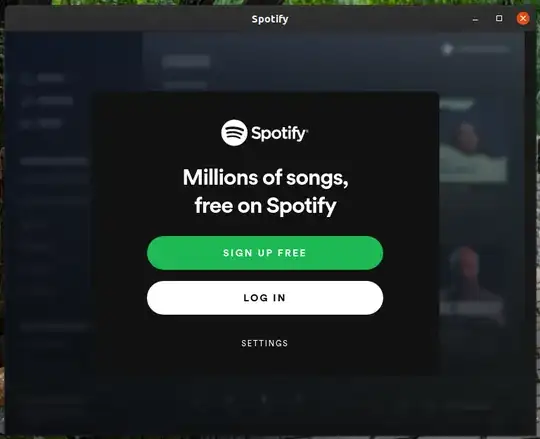

$ flatpak run com.spotify.Client
Note that the directories
'/var/lib/flatpak/exports/share'
'/home/spacer/.local/share/flatpak/exports/share'
are not in the search path set by the XDG_DATA_DIRS environment variable, so
applications installed by Flatpak may not appear on your desktop until the
session is restarted.
/app/extra/bin/spotify: /app/lib/libcurl-gnutls.so.4: no version information available (required by /app/extra/bin/spotify)
Gtk-Message: 19:58:38.385: Failed to load module "atk-bridge"
Gtk-Message: 19:58:38.423: Failed to load module "canberra-gtk-module"
/app/extra/share/spotify/spotify: /app/lib/libcurl-gnutls.so.4: no version information available (required by /app/extra/share/spotify/spotify)
/proc/self/exe: /app/lib/libcurl-gnutls.so.4: no version information available (required by /proc/self/exe)
Spitify started successfully: spotify window
Check commands starting from $ sign if you've executed them.
Also, you could try creating new user:
sudo adduser newuser && sudo usermod -aG sudo newuser
log in with it and try again.
