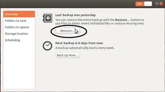

Step 3: Open Deja Dup
Search for Backups in the application launcher and open the app. Select Restore:

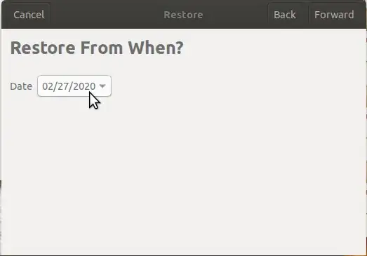

Step 5: The Date of Backup
Select the date of the backup you want to restore, the default is the most recent:
Select Forward

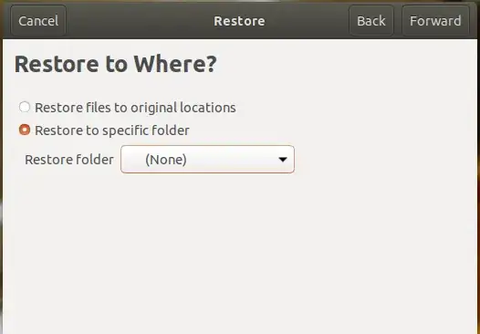

Step 6: Restore to Where?
Here you need to change the default setting to Restore to specific folder
Click on the Restore folder (None) and navigate to the folder you created either in the internal drive or in the second USB drive.

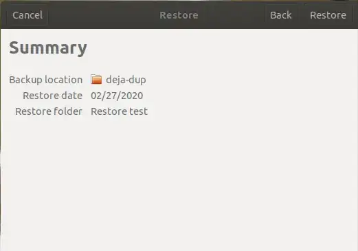

Step 7: Click Restore
Read the Summary information and make sure they are correct. and hit Restore. Wait for a few hours/days/weeks, depending on the amount of data and the speed of the the USB drives involved.
