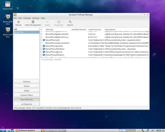

Package managers are an easier bet though; as they list all packages and not just 'selected' ones like Software Centre. synaptic is installed by a default Lubuntu 18.04 LTS installation (https://packages.ubuntu.com/bionic/lubuntu-desktop) and is another option, though there there are many others too. enter image description here
Also please note I booted a very recent QA-test install of Lubuntu 18.04.4 (for the picture), and no LibreOffice packages are installed by default (see prior list of packages installed) so none were found. Your packages may have been installed manually, thus removing them will depend on how you installed them, thus prior details could differ if you installed flatpak, snap etc.
Lubuntu 18.04 LTS comes with abiword and gnumeric only by default, not LibreOffice.
