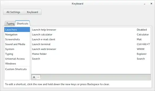

Go to System Preferences then Keyboard and click Shortcuts then Custom Shortcuts:
Keyboard shortcuts

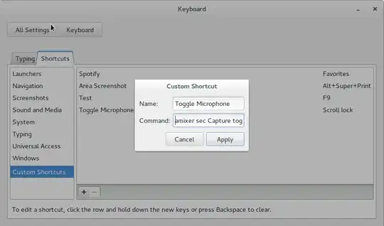

Click on Add
Custom shortcut
Fill in:
Toggle Microphone
and
amixer set Capture toggle
For USB webcams you need to chose the device (-c 1), or maybe another number.
amixer -c 1 sset Mic toggle
Click Apply and then associate a new key with this command (e.g. the Pause/Break key).
