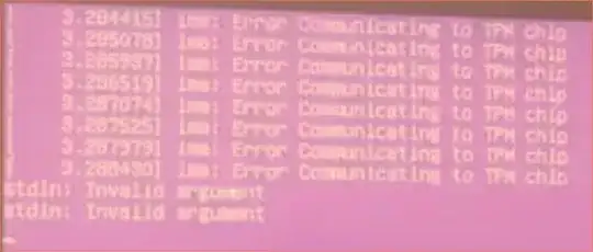

I recently purchased an Intel NUC10i7FNH-based system and wanted to boot from a LiveUSB drive loaded with Ubuntu Linux 19.10 LTS. However, after a few seconds the screen goes blank and the machine shuts itself down.
Before shutting down, the following message is displayed on the screen:
Error communicating to TPM chip

Unrelated, but we also recently purchased a handful units of the same model, NUC10i7FNH, to run our CI/CD pipelines, and our custom Yocto OS isn't booting on these guys either.
Installed Wednesday - Ubuntu 19.10.
NUC10i7FNH1, Crucial 32G (2x16G) 2666 RAM, WD Black 1TB NVME, Samsung 2T EVO 860 2.5"
Hangs if you enable updates during install (while fetching grub2 update).
Without updates, installs fine (from usb stick), then after updating via wifi, the ethernet works also (with 5.3.29 kernel). Wifi seems supports 802.11ac only, but not WIFI6.
This seems like it might be a problem, but it works fine:
Feb 12 13:48:52 u32 kernel: [    0.396873] smpboot: CPU0: Intel(R) Core(TM) i7-10710U CPU @ 1.10GHz (family: 0x6, model: 0xa6, stepping: 0x0)
Feb 12 13:48:52 u32 kernel: [    0.396968] mce: [Hardware Error]: Machine check events logged
Feb 12 13:48:52 u32 kernel: [    0.396971] mce: [Hardware Error]: CPU 0: Machine Check: 0 Bank 10: 8c20000000041136
Feb 12 13:48:52 u32 kernel: [    0.396972] mce: [Hardware Error]: TSC 0 ADDR 2a5e1080 MISC 3040038086
Feb 12 13:48:52 u32 kernel: [    0.396975] mce: [Hardware Error]: PROCESSOR 0:a0660 TIME 1581544124 SOCKET 0 APIC 0 microcode c6
The TPM error remains (no TPM or vPro):
Feb 12 13:48:52 u32 kernel: [    2.439905] ima: Allocated hash algorithm: sha1
Feb 12 13:48:52 u32 kernel: [    2.452046] ima: Error Communicating to TPM chip Feb 12 13:48:52 u32 kernel: [    2.452770] ima: Error Communicating to TPM chip
Feb 12 13:48:52 u32 kernel: [    2.453494] ima: Error Communicating to TPM chip
Feb 12 13:48:52 u32 kernel: [    2.453989] ima: Error Communicating to TPM chip
Feb 12 13:48:52 u32 kernel: [    2.454510] ima: Error Communicating to TPM chip
Feb 12 13:48:52 u32 kernel: [    2.454928] ima: Error Communicating to TPM chip
Feb 12 13:48:52 u32 kernel: [    2.455345] ima: Error Communicating to TPM chip
Feb 12 13:48:52 u32 kernel: [    2.455763] ima: Error Communicating to TPM chip

I just brought up Kubuntu on an Intel NUC10i7FNH, running 32 GB Corsair Vengeance memory and a WD BLUE SN550 1TB SSD.
Per recommendations above, I declined getting updates during installation. I have been presented with a functional machine in as little as 15 minutes (I didn't time the installation, but it completed while I was watching the screen, so it was quite a rapid installation). I am writing this from the system. I have yet to go through the WiFi system- I am using the built-in Ethernet port. I also have not tried the audio features, but I will check as to whether the audio works through the HDMI port, and go from there. Thank you, Ubuntu community, for making this little computer work out of the box. Oh, and yes, I did update the firmware prior to attempting the installation.
