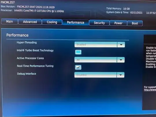

I finally got my NUC10i7FNH operational with Ubuntu 20.04. I disabled lots of stuff in the BIOS (Bluetooth/Wi-Fi, HDMI TV controls), but the big one that finally worked was turning off Intel Turbo Boost Technology on the PerformanceProcessor page.
I went back later and started enabling all the items I had recently disabled. The boot failed, so there is a combination of settings that worked. My changes were all on the Advanced tab in the BIOS, and the one checkbox on the Processor page.
BIOS settings

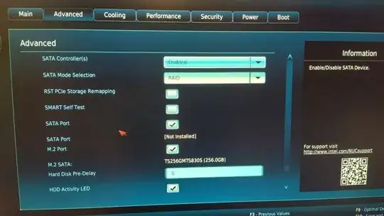

I also had a lot of problems running Ubuntu 20.04 TLS, I bought NUC10FNK, the problems I had was related to the disk, type M2, I installed several times, with different USBs and different files, each time different errors, mainly had a read-only filesystem error...
This is the configuration in which it worked for me in the end:
Changes I made to the BIOS:
I turned off all the features I did not need such as - Bluetooth, HDMI CEC ...
In STORAGE I turned off the SMART SELF TEST and after installing the OS, I changed the SATA MODE from AHCI to RAID ...
In the process of installing the UBUNTU:
I chose a minimal installation, deleted the disk, and did the installation without internet connections...
Now it seems to be working...
The STORAGE settings in the BIOS
