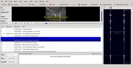

The quickest/easiest method to sync subtitle with Subtitle Composer is:
  1. select a title near the video start and press Alt+A (Menu - Times > Toggle Anchor)
  2. drag that anchored title to correct position on waveform
  3. select one title near the video end and anchor this one too with Alt+A (keep first one anchored too)
  4. drag second anchored title to correct position
That should be enough for synchronizing most titles as they are usually linearly distorted - otherwise keep repeating steps 3 and 4 on other titles which are off.
At some point there will be ability to sync titles using speech recognition in SC, but not yet.
