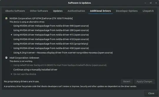

  • Software & Updates
    Software & Updates

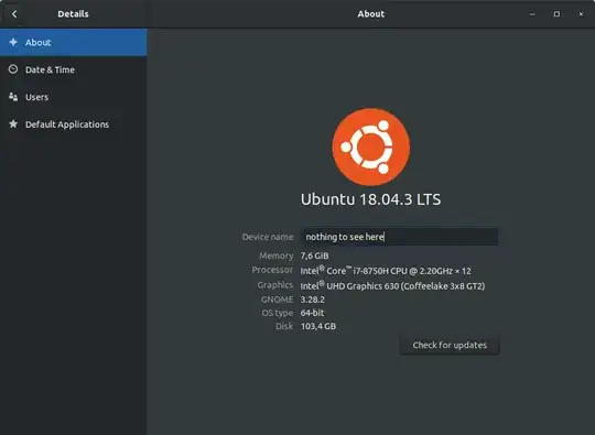

  • About Ubuntu:
    About Ubuntu

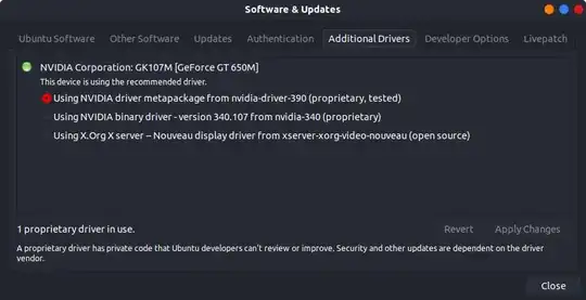

Have you tried going to the Software & Updates menu?
I installed my drivers during the installing of Ubuntu by allowing 3rd party drivers, but still had to come here to select it.
Hope it helps.
