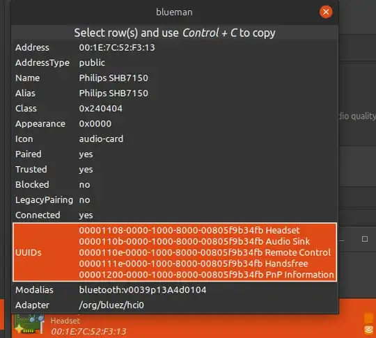

To disable a specific device only (Ubuntu 20.04 & 22.04), find the UUID for the device's services. You can do this in Blueman:
blueman uuid
It can also be obtained by running bluetoothctl info and other methods as well.
Next, edit the following to remove the UUID from "Services" under "General".
# For Ubuntu 20.04
sudo vim /var/lib/bluetooth/{{deviceid}}/info
For Ubuntu 22.04
sudo vim /var/lib/bluetooth/{{controller}}/{{deviceid}}/info
Then restart bluetooth
sudo systemctl restart bluetooth.service
