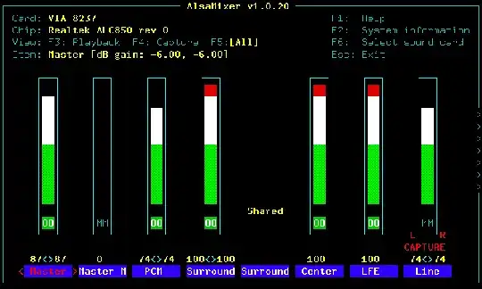

Your equalizer should be set-up. To use it, run
alsamixer -D equal
TADA! Your alsamixer will now behave as an equalizer, instead of adjusting volumes. Hope this helps!

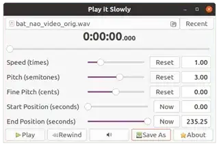

Play it slowly
playitslowly (official documentation) is a GUI, which also provides for a change in pitch. See also here.
