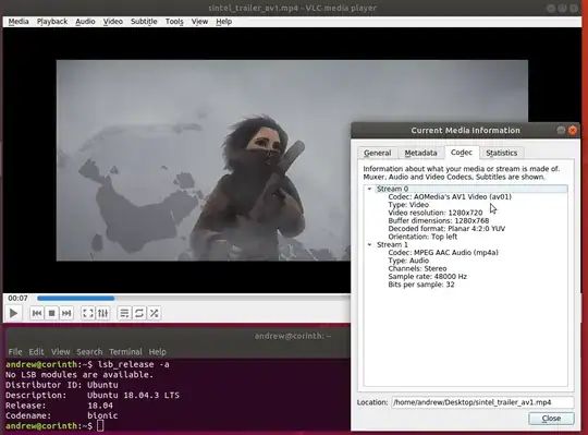

This will give pretty up to date AV1 abilities on Ubuntu 18.04, I add a screenshot of vlc with AV1 playback on my own 18.04 system (the video was one I created myself from the 'Encoding' guide above in point 2):
It all works nicely on my system and should on yours as well :)
