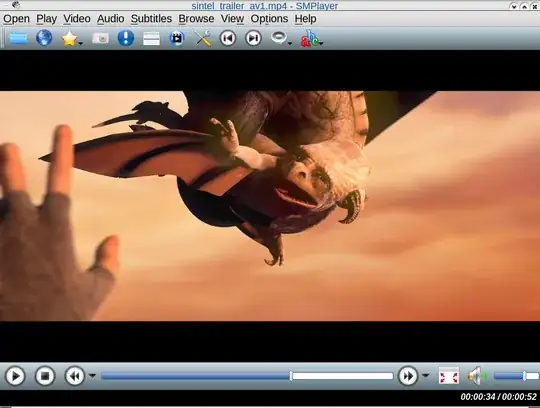

5. Gratuitous screenshot
OK so there is an optional 5th step; taking a screenshot of the completed output file running :)
