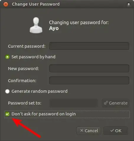

First method:
Go to “System -> Administration -> Users and Groups” on the top panel.
Click on the user you want to set up auto-login for and click “change” on the Password field.
If “Don’t ask for password on login.” is checked, uncheck it.
