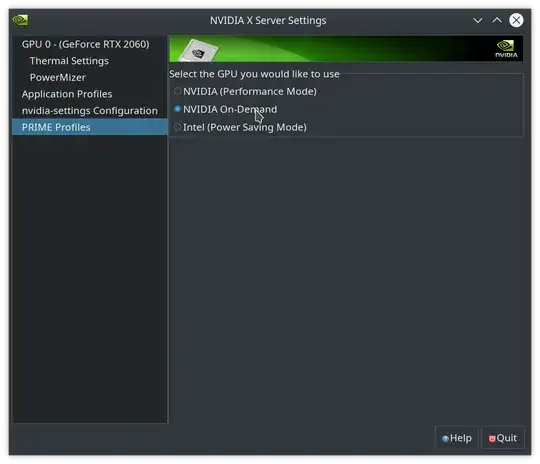

you can set the 'on-demand' option also in the GUI: Nvidia X Server Settings - PRIME Profiles: NVIDIA On-Demand
enter image description here then restart.
then you can start your application with the environment variables also directly from commandline - so you can switch GPUs as needed:
