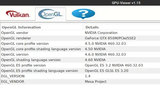

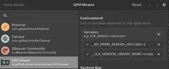

for our testing we will do OpenGL with the GPUViewer application
flatpak override --env="__NV_PRIME_RENDER_OFFLOAD=1 __GLX_VENDOR_LIBRARY_NAME=nvidia" io.github.arunsivaramanneo.GPUViewer
Flatseal
flatseal setting GPUViewer to use PRIME offloading
Testing
Launch GPUViewer and go to the OpenGL tab, You should see the Nvidia graphics cards selected. If it still shows the Intel card then the offloading is not working.
