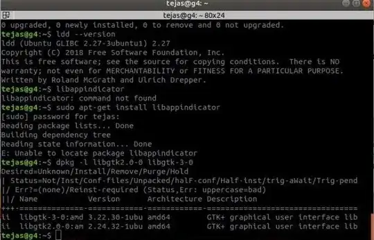

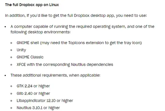

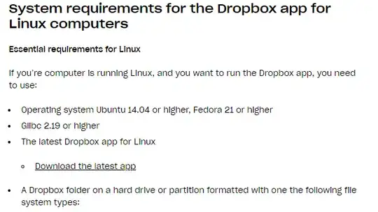

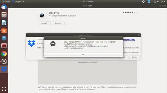

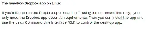

I did not use my computer for a month. On starting Dropbox after opening it, it shows the following Could not start dropbox daemon On checking the Dropbox site for system requirements System requirements enter image description here enter image description here enter image description here So I went about checking all these requirements, GTK went about checking

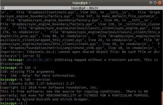

Glibc also (ldd in ubuntu) glibc

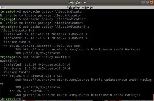

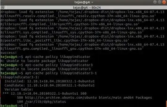

Libappindicator 12.10 or higher libappindicator
Nautilus 3.10.1 or higher nautilius

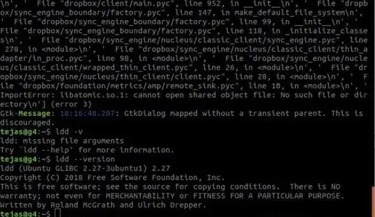

I just noticed that one of my photos had the error of
libatomic.so.1: can't open
Blah
libatomic error detect

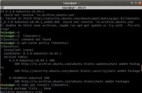

On searching for libatomic in askubuntu I found answer1. This was a question about failure to implement answer2.
Anyway on running the following command (as in answer2 )
sudo apt install libatomic1
It was fixed. Dropbox GUI and CLI are working now.
