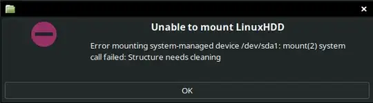

Recently one of my drives refused to mount, showing the error message below:
Now luckily I was able to fix this thanks to another question on Ask Ubuntu that you can find here: "Structure needs cleaning" error - cannot mount partition
Basically I just had to fix the system, I entered the command:
sudo fsck.ext4 /dev/sda[NUMBER]
Just as stated in the answer to that post. That worked and everything in my drive is restored.
