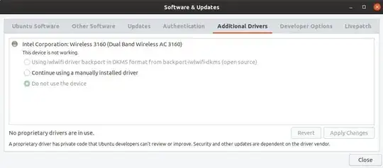

Also in the Additional Drivers, it says it is not installed. Look: Additional Drivers
