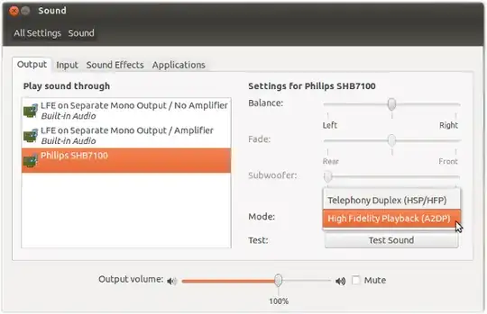

Although the device is successfully connected I am not able to hear any sound into the headphones. Some interference noise is produced instead.
I have solved it by following the steps below:
  • open the Sound Settings;
  • select the device in the "Play sound through" pane;
  • select "High Fidelity Playback (A2DP)" in the "Mode" combo box;
  • make sure the "Mute" checkbox is unchecked.
