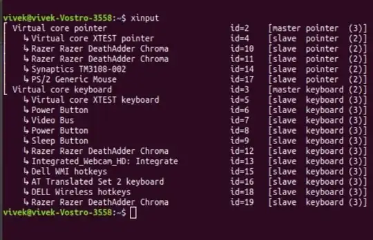

Following are output of xinput
As, you can see in the above image it is able to detect Synaptics TM3108-002 (synaptic touchpad) but yet the touchpad is still unresponsive
