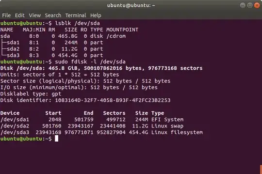

I ran these two commands in terminal; commands
And the SSDs mountpoint is listed as /cdrom
Could this be what’s causing the swap creation failure in the installer? If it is, how can I fix it? If it isn’t what commands can I run to troubleshoot this issue?

Using the live USB I unmounted, and edited the SSD via the Disks tool; resetting it to its default state, then rebooted and reinstalled Ubuntu with no issues. I didn’t have to manually partition the drive like before.
