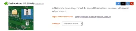

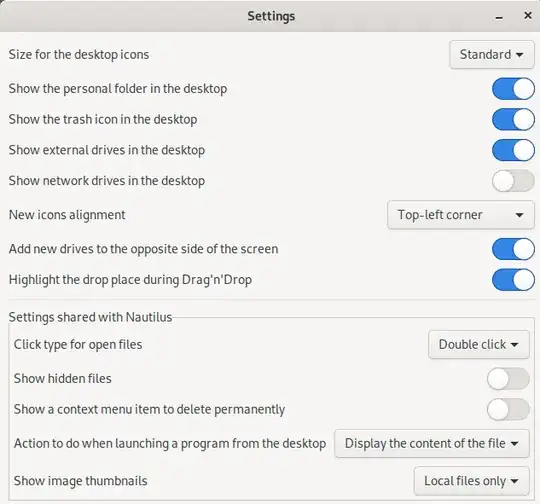

Another possibility is to uninstall the "Desktop Icons" extension and install this one:
https://extensions.gnome.org/extension/2087/desktop-icons-ng-ding/?c=80141
I lightly tested it, and for now drag and drop works as supposed to do and moving icons in different screens also.
Additionally, it's much more configurable:
