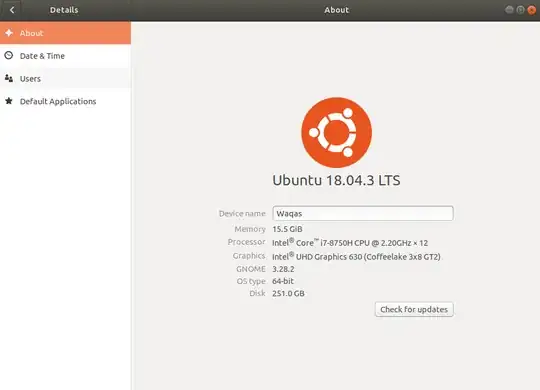

Finally it asked me to enter a pass as I had my "Secure boot" enabled, saying it will be required upon the reboot. Although the installation fairly well without any hiccups, the thing I do not understand is when I had rebooted and saw Nvidia X Server Settings in my application, starting it showed only the "Prime Profiles" section on the left pane and it did not show other options. Also, even though I had selected Nvidia under the profile section, the Ubuntu>Settings>Details>About still shows "Intel UHD Graphics 630" as the display driver:

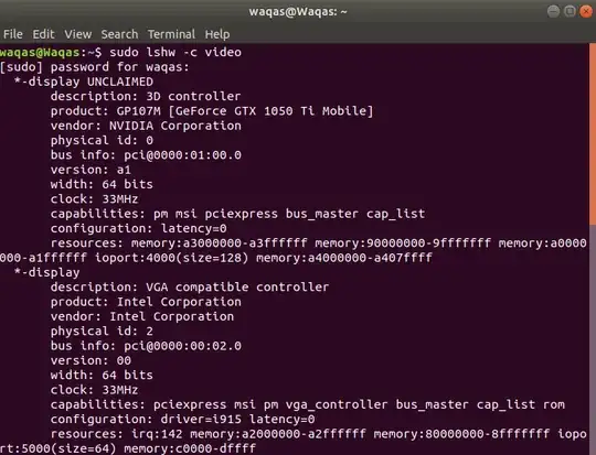

And finally, when I used the terminal to see the display details. I got this:
Normally, the output of this command shows "drivers" in "configuration" before "latency", just as it does for Intel showing "i915" but it did not show any drivers for Nvidia. Also, the display showed to be UNCLAIMED.

You need to disable Secure Boot to load Nvidia proprietary drivers, or sign them that is not quite straight forward.
See this question for more details: Why do I get “Required key not available” when install 3rd party kernel modules or after a kernel upgrade?
Also note that ALL proprietary Nvidia drivers are non-free. They are erroneously shown as "free" from a PPA.
