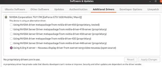

Furthermore, when I try to download and use any of the drivers for the nvidia graphics card my computer will no longer boot successfully. It just stays on the black screen with the dell and ubuntu logos and will not progress past it. It requires a hard shut down then to select the driver indicated in the image in recovery mode. All the nvidia drivers in the image cause the boot issue.

I went deep in the rabbit hole on this one, so I'd like to help anyone who experiences the same problem.
This question is very similar to this one and both the answers are helpful, albeit at the time of writing this post, none of them is accepted.
The answer is well described here and here. The most important thing is that when you are installing the drivers, and later, while using them, SecureBoot MUST be disabled.
Step By Step Guide
You need to (step by step):
  • (optional) To start clean, you can purge all configs you tried to install so far:
sudo apt purge '^.*nvidia*'
sudo apt install ubuntu-desktop
sudo apt purge "^.*cublas*"
sudo apt purge "^.*cuda*"
sudo mv /etc/X11/xorg.conf /etc/X11/xorg.conf.old
sudo apt autoremove
  • Reboot, and disable SecureBoot in the bios. That's extremely important, otherwise the drivers won't load
  • After SecureBoot is disabled, then you run the following commands:
sudo ubuntu-drivers devices
sudo ubuntu-drivers autoinstall
reboot
  • once you reboot, you can verify that your drivers are working by issuing:
nvidia-smi
Verify Working Drivers
If your drivers are working, when you issue nvidia-smi you are going to get some output like:
Sat Nov 13 17:02:26 2021
| NVIDIA-SMI 470.82.00    Driver Version: 470.82.00    CUDA Version: 11.4     |
| GPU  Name        Persistence-M| Bus-Id        Disp.A | Volatile Uncorr. ECC |
| Fan  Temp  Perf  Pwr:Usage/Cap|         Memory-Usage | GPU-Util  Compute M. |
|                               |                      |               MIG M. |
|   0  NVIDIA GeForce ...  Off  | 00000000:01:00.0 Off |                  N/A |
| N/A   50C    P8     2W /  N/A |      9MiB /  3914MiB |      0%      Default |
|                               |                      |                  N/A |
+-----------------------------------------------------------------------------+ | Processes: | | GPU GI CI PID Type Process name GPU Memory | | ID ID Usage | |=============================================================================| | 0 N/A N/A 1484 G /usr/lib/xorg/Xorg 4MiB | | 0 N/A N/A 2041 G /usr/lib/xorg/Xorg 4MiB | +-----------------------------------------------------------------------------+
Not Working Drivers
If something went wrong, you are going to see something like:
NVIDIA-SMI has failed because it couldn't communicate with the NVIDIA driver. Make sure that the latest NVIDIA driver is installed and running.
The above answer for me didn't work entirely because when running sudo ubuntu-drivers autoinstall it would return that my drivers where already installed.
So, I was using Ubuntu 22.04 with NVidia GeForce GTX 1650 and couldn't share screen on Discord. I tried changing to the system recommended driver, but it stopped my PC from booting.
I found a solution and came here to share it.
how I did it
  1. Start your system on safe mode by holding shift in the initialization
  2. run sudo apt-get purge nvidia*
  3. run lspci | grep -i nvidia just to check if you really have a GeForce GTX 1650. The answer for me was
01:00.0 VGA compatible controller: NVIDIA Corporation TU117M (rev a1)
This meant I had it and could continue with the proper driver: nvidia-driver-525
If you discover that you have another board search for the right driver for it.
  1. run on the terminal sudo apt install nvidia-driver-525
Reboot :)
