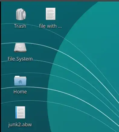

If an item is not selected, you'll see this:
icon with only one line of text

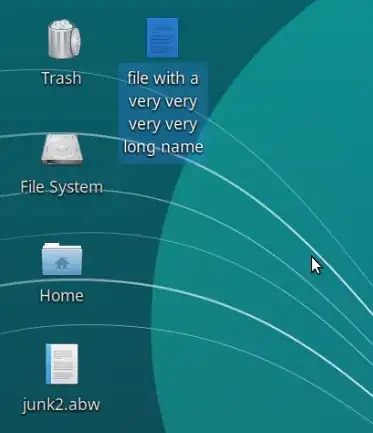

But if you click on the item, you'll see this:
Icon with expanded text: filename with spaces

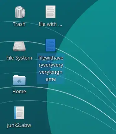

Or this:
Icon with expanded text: filename has no spaces

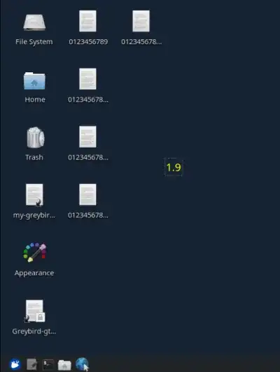

For either of these themes, open the gtk-2.0 folder and then open the gtkrc file. Search for the line below:
XfdesktopIconView::cell-text-width-proportion = 1.9
Increase the value from 1.9 to meet your needs. To test, save the file, switch themes away from Greybird and then back to Greybird using the Appearances application.
Note that if we consider the desktop surface to be a grid, a higher value will increase the dimensions of each cell in the grid resulting in fewer total rows and columns. You can see how the item below the Appearances icon get pushed down and even out of sight as this animated gif shows:
Animation showing increased length of labels
