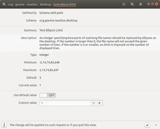

To get the icon text, however long, to be restricted to one line and shortened, one can use dconf-editor which may need to be installed on your system if it isn't already present: sudo apt install dconf-editor should do it.

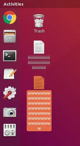

For this purpose, I created a file with just w repeated fifty times. This is what it looks like when I highlight it on the desktop:
full name
and without highlighting it:
three rows
Now, by means of dconf-editor, one can change it to just one row:
dconf-editor
I found I needed to log out and log back in to see:
one row

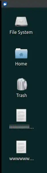

Xubuntu 18.04
Here, the default is just one line, truncated. How many characters fit in on that line depends on the width of the characters involved:
Xubuntu 18.04
