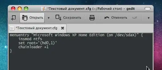

    Try to add
menuentry "Windows XP " { set root='(hdX,X)' chainloader +1 }
in boot/grub/grub.cfg to section
(hdX,X) - drive with windows xp
SAMPLE:
`### BEGIN /etc/grub.d/40_custom ###
set root='(hdX,X)'
chainloader +1
Maybe help to You :) Look for 13 post
