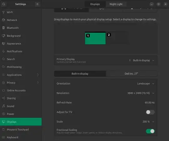

I found that I needed to not only change the scale, but also enable "Fractional Scaling" in Settings > Displays to solve this problem. My first monitor was 3840X2400, and my second monitor was 1920X1080. I set the scale of the first to 200%, the second to 100%, and enabled fractional scaling.
After I enabled the Fractional Scaling I had to move the screens around in the GUI to get them to be side by side (they were separated). Now I have both monitors at different scales.
