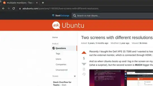

I found this question/answer that suggested using the fractal scaling option to get screens to act as if they were same size. I want this so there is no "screen wall" on the built in display of my laptop a gaze16 more information about my laptop can be found here: https://tech-docs.system76.com/models/gaze16/README.html
To be clear I have the 3050 graphics card and I am using the nvidia-driver-530 running Ubuntu 22.04.2 LTS (Jammy Jellyfish)

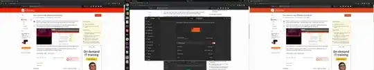

Basically if I am using 2 screens being the hdmi output and the built in display I can use the fractal scaling without issue. Though when using the display port with 2 or 3 displays and enabling fractal scaling it seems like the display port uses the setting that is suppose to be for the hdmi port.
A screenshot of how i want it shows all 3 displays as the same size but I have to go off screen view to take this screenshot: A screenshot of how i want it shows all 3 displays as the same size but I have to go off screen view to take this screenshot
This picture is of what the right side screen (display port) actually shows on the monitor: This picture is of what the right side screen (display port) actually shows on the monitor
I was thinking xrandr verbose output might while fractal scaling is on might help someone help me so here that output.
