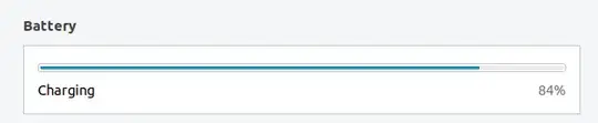

Even, the battery always display "Estimating..." in the menu although the correct % is displayed in the settings:
Menu:
Settings:
