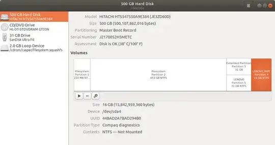

The more serious problem is that the G570 was not supplied with Windows 7 installation disks. If you try to download an ISO file from Microsoft with a G570 product key, they will refuse and direct you to your OEM. Lenovo also do not supply installation disks for the G570. Because of its IBM heritage, the G570 instead comes with a product called OneKey Recovery 7.0 (OKR), which enables you to re-install or repair Windows 7 from a hidden partition called "LENOVO_PART" on the original hard drive. OKR is launched from a special button on the G570, which is controlled by a custom boot partition. In addition, OKR stores hidden files and backups on a logical partition called "LENOVO" (which Linux and Windows otherwise regard as a completely normal partition for data storage).
https://i.sstatic.net/s9BAp.png
If you wish to completely and irrevocably replace Windows 7 with Ubuntu, this is not a problem. But if you want to be able to use Windows software again, now or in the future, it is therefore critically important that your installation does not touch either the hidden OKR partition or the custom boot partition and does not delete the "LENOVO" logical partition. Deleting any of these partitions will prevent Windows from booting. Attempting to backup the hidden partition in its default state will also prevent Windows from booting. If Linux does alter anything, then you may be able to repair it using a retail Windows 7 installation (not System Repair) DVD, but Microsoft no longer sells these, and you must use an SP1 DVD.

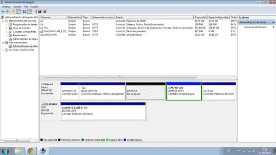

More positively, user asanchez1987 on the CentOS forum reports that they were able to install CentOS onto a G570, without damaging either Windows or OKR. They first shrank the Windows primary partition (C: or /sda2) by 100GB. This left a gap in the middle of the drive: A G570 with the second primary partition shrunk; credit to asanchez1987 on the CentOS forum They then moved the start of the extended partition earlier in the disk using gparted (on a live CD). They then used CentOS' installation procedure to insert the boot partition at the start of the extended partition. They used something called an "LVM Physical Volume" to create the CentOS system and swap partitions. I suspect, but cannot prove, that this scheme was successful because it not only left the hidden partitions and files intact, but also preserved them at exactly the same bytes on the hard drive. Unfortunately, it is probably not possible to exactly replicate this method with Ubuntu, because the Ubuntu installer insists on placing Grub in the MBR. In fact, it is puzzling how CentOS was able to this without altering the MBR. It may be noteworthy that asanchez1987 never explicitly stated that they were still able to boot Windows after installing Linux.
