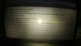

Like this (Excuses me because of low quality photo which i could not take screen shut from my Linux!!!):
It also have found nvidia-driver-440 as recommended as you could see here:
root@so-notebook:~# sudo ubuntu-drivers devices
== /sys/devices/pci0000:00/0000:00:1d.0/0000:03:00.0 ==
modalias : pci:v000010DEd0000134Fsv000017AAsd000039F1bc03sc02i00
vendor   : NVIDIA Corporation
model    : GM108M [GeForce 920MX]
driver   : nvidia-driver-410 - third-party free
driver   : nvidia-driver-390 - third-party free
driver   : nvidia-driver-435 - distro non-free
driver   : nvidia-driver-440 - third-party free recommended
driver   : nvidia-driver-430 - distro non-free
driver   : nvidia-driver-415 - third-party free
driver   : xserver-xorg-video-nouveau - distro free builtin
== /sys/devices/pci0000:00/0000:00:14.0/usb1/1-7/1-7:1.1 == modalias : usb:v0BDAp0821d0200dcE0dsc01dp01icE0isc01ip01in01 vendor : Realtek Semiconductor Corp. driver : rtl8812au-dkms - distro free

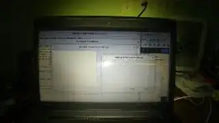

So in software Updates have this configuration:
So as you can see it have been installed but nvidia-smi said:
root@so-notebook:~# nvidia-smi
NVIDIA-SMI has failed because it couldn't communicate with the NVIDIA driver. Make sure that the latest NVIDIA driver is installed and running.
