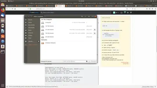

I have tried to install Ubuntu from live USB and trying to format /dev/sda3 and /dev/sda7 and setting them to /home/ and / Respectively but during instillation it got some error and for new restarting from live USB it stuck in installation process and now it can not show my hard drives for first time and after running sudo fdisk -l it showed my hard partitions except /dev/sda7 as you can see here:

So what do you suggest doing according this post:
This has been asked in many places. You need to change SSD controller setting in BIOS from RAID to AHCI, or Linux won't find it.
But the downside is that you need to fix or re-install your Windows in AHCI mode.
Why one of partitions don't shown after using fdisk command?, Also after doing this is my dual boot deleted or not? if yes how can recover again it to have access to win and Ubuntu like before migration with new Ubuntu OS?
