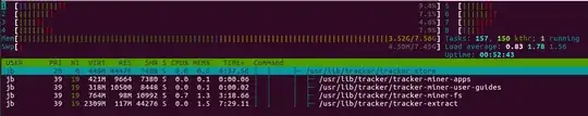

I'm trying to understand what the different background processes are doing on my machine as this one is freezing from time to time. I have noticed that the tracker processes (there are several of them as you can see on the screenshots) take a lot of CPU power. I also noticed that if I kill those processes, it solves the issue and nothing weird or at least nothing visible really happen on my machine.
Do you know what is exactly the use of those processes and why they are taking so much CPU power (what are they doing with all that power?) I tried to do a couple of searches online regarding the tracker processes but I can't really understand what they do. :/

tracker -store taking a lot of CPU power :
tracker -extract taking a lot of CPU power :
tracker -extract taking a lot of cpu power

Tracker, which is enabled by default in Ubuntu since 19.10, is a file metadata indexer. It indexes your files to allow for fast searching for content in files from Files or Gnome Documents, find pictures in Gnome Photos, allow to rename files based on metadata, and so on. The different processes you see are processes that crawl your file system, read the file contents and index that contents in database indexes for fast search through Tracker-aware interfaces, such as Files and Gnome Shell activities overview.
Until Ubuntu 19.04, Ubuntu developers removed Tracker from Gnome Shell when they started to use it in Ubuntu 17.04. Performance issues were the reason. The first time, the full index is created, which takes significant time. Subsequently, the index is updated on the fly, which as such does not incur severe performance penalties. Nevertheless, even on a fully indexed system, there is intensive processor use for many minutes shortly after log in. On a system with a modern multicore processor, this does not significantly affect interactive processes, but on older systems, it could lead to significant perceivable decrease in system response for up to ten minutes.
Tracker increasingly is more integrated with Gnome Shell and currently is a hard dependency of file manager nautilus (aka "Files"). As a result, Tracker is enabled by default in Ubuntu versions after the long term release 18.04 (i.e. 19.04, 19.10 and later).
Disable Tracker
To avoid the period of high processor use after login, you may want to disable Tracker. This will disable full text search and renaming of mediafiles based on tags. It will disable the "Starred files" feature (Ubuntu 20.04). However, file name search in Files will continue to work. In the overview, it appears as if only recent files are found after disabling Tracker.

here's simpler approach to removing this entirely.
Anything that inhibits user input by causing system load exceeding 5 right after boot sounds like a problem to me. This is my solution:
apt purge tracker tracker-extract tracker-miner-fs
This was a problem on a fresh install of Ubuntu 20.04.2.
