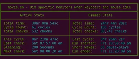

Edit script based on system activity
OP has clarified needs. Multiple jobs can be running. The first one that ends would reactivate sleep which will prevent remaining jobs from completing.
A scaled down version of this script is needed:
  • Removing dimming / brightening of monitors
  • Remove list of selective monitors to process
  • Remove checks for keyboard / mouse idle (which gnome uses for sleep activation)
  • Drastically reduce statistics summary screen or remove all together
Then the code using xprintidle (keyboard and mouse unused time) needs to be yanked out and replaced with:
$ uptime
 08:08:54 up 9 days,  3:38,  1 user,  load average: 0.30, 0.47, 0.71
The load average prints for 1 minute, 5 minutes and 15 minutes. Once 5 minutes or 15 minutes is below threshold, simply suspend the system.
