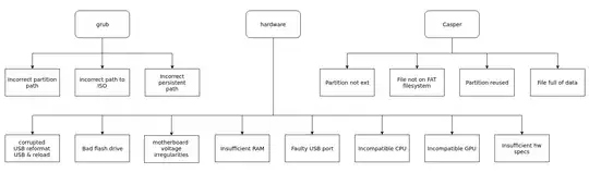

If this was part of a flowchart I would group all of the hardware reasons as child nodes branching out from the same parent hardware node. Similarly I would group the Casper nodes together and the grub nodes together, branching out from a Casper parent node and a grub parent node respectively.
flowchart1
(Click images to enlarge)
flowchart2
