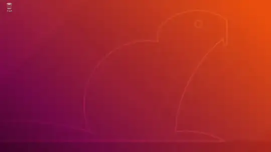

Image Showing there is no Top Panel enter image description here

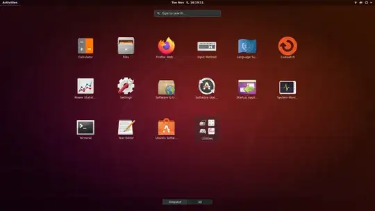

Image Showing there is no Dash enter image description here
