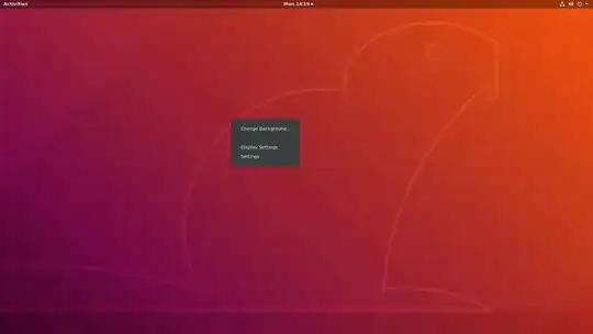

Problems:
  • Right click only brings up "Change Background...", "Display Settings", and "Settings". Before it would have a lot of options like like "create new file"...
  • Side bar missing. I can only see it when I click on the activities...
  • There is no Dock in the settings
What my desktop looks like

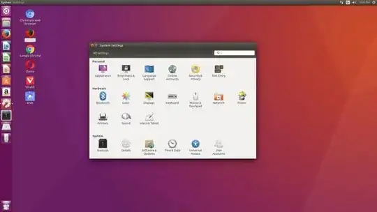

I would like to return desktop to its original state...
It used to look similar to this: enter image description here

First, install GNOME Tweaks as recommended by https://www.linuxuprising.com/2019/03/how-to-reset-gnome-desktop-settings-to.html and K. Monty; open a terminal, and run
sudo apt update && sudo apt install gnome-tweaks
then launch it, click on the upper panel at left on Tweaks, and choose Reset to Defaults. Then, logout and login again.
If that does not resolve the issue, then open a terminal and make a backup of dconf settings recursively with cp
md ~/dconf.bak && cp -r ~/.config/dconf/user ~/dconf.bak
Once the backup is made, tell dconf to reset to defaults
dconf reset -f /org/gnome/
Logout then login again. Check back with us if anything unusual occurs; we're here to help.
